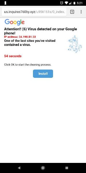

Not sure why but going to that site brought up one of those bogus virus warnings

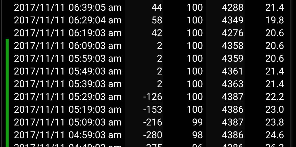

If your phone is on, at 100%, and connected to a charger, it most certainly is still charging. It's not pulling enough juice to overcharge.. it's just pulling enough power to maintain a full charge. Here's a recent chart from my 2XL
That middle column is the current in mA. Negative numbers mean charging. A typical idle draw for this phone is about 45 mA... Once the battery hits full, the current is 2 mA, the only way that can happen is if it's still pulling down power.
Sure, it's not a ton, but it's still charging. You do that for 6, 7 hours a night, every night, that stress will add up.
Sure, sure. Applying a charge of fifty-eight thousands of one percent of the battery's capacity is dreadfully damaging.
I never said it was dreadfully damaging, only that it will reduce the life of the cell. You let it sit overnight, every night, that's what, 2000 some odd hours over the course of a year? A little bit of stress over a long time.. that can, and will, add up. There are other factors, of course... As I mentioned earlier, the peak charging voltage is just as crucial here. Phones that pushed that to the limit (such as the 6P) will degrade much quicker... And that phone was just 50mV higher than usual.
