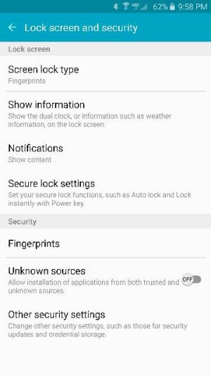

i don't see samsung find my mobile under lock & security. I have a verizon version of the note 5

Nope this is what I have.
And this is why I hate carriers having their own twist on software. Samsung's Find My Mobile is great for locking and unlocking the screen. Would have worked exactly in the above situation.

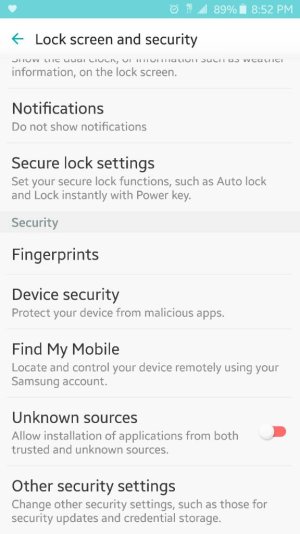

so I was just in contact with verizon support. Verizon did not disable that feature. The verizon support person has a Galaxy S6 and she has Find my mobile under Lock Screen & Security in settings. I might have to factory reset my phone, not sure why mine doesn't have it
Mine doesn't have it either so it's another thing left off by the Verizon overlords.
