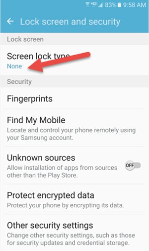

OK , People try this .. So far it works for me since last night ..
Clear out or remove all your password + patent lock, finger print or any kind 0f lock on your phone until you see " Screen lock set None "
Reset your phone , you should be able to log in directly ..
Now ... set your lock screen again .

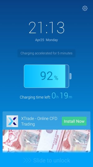

If your second lock screen looks like the picture here then the problem is the "DU Quick Charger" adware app.
The straightforward solution is to uninstall whatever apps secretly installed "DU Quick Charger".
The same stackexchange page lists some of the apps which do this, such as ES File Explorer V4.0.5. If you need help figuring out which apps are responsible, see How can I find which apps/packages reference a given permission using command line?

Yes, I did: The symptom is a second lock screen that you must swipe to unlock, and people have pretty much ruled out the OS-update hypothesis. How is the symptom different than the DU adware? A screen shot would help.
See the steps in Determine which app is drawing on top of other apps? to find which apps could be causing the problem. Removing their "Draw over other apps" permission or uninstalling them would fix it. Note that it's possible that more than one app is causing the problem.
The point is, it's time to move on to testing which apps could cause the problem.
Actually, I think he is right. If that second lock screen is the one he displayed, it should be due to the ES File Explorer. I read through the entire chat, and tested this myself. On that second lock screen, on the top right, there is a settings button. If you click on that, it leads you to ES Charging Boost. Turn that off, and the second lock screen is gone. I used to have that second lock screen display every time I locked my phone, and now, even after restarting, it does not appear. I only know that this remedy applies for that specific lock screen posted by Jerry, if there is any other one, I do not know if it will work.
