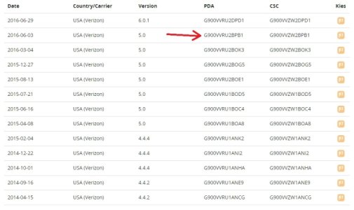

  1. Does a firmware image listed on sammobile.com have to match my PDA and CSC codes "EXACTLY"? If not, then what portion of the code must match? If it doesn't match, will it brick the phone? (Latest 5.0 rev for my phone is PDA:[FONT=&quot]G900VVRU2BPB1 and CSC:[/FONT][FONT=&quot]G900VVZW2BPB1)[/FONT]

1. No. The last 5 digits can change with each firmware release. The last 3 denote the build date and number details. see #1.8 of 42 Galaxy S5 models - Dummies Guide for more details.

In reference to item 1:
Well, yes, the available PDA code does match up to 9 of 13 characters. But the CSC code only matches up to 6 of 13 characters. Not the requisite 8 of 13. Or does that matter? Is the PDA the only thing to worry about?
