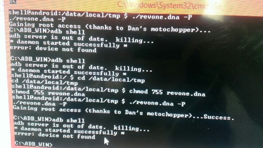

Anyone who managed to do this correctly, this is the problem I am running into. After the root command, it says gaining root access, and my phone reboots. Per the instructions, I wait two minutes and start back at adb shell. But after the reboot, it says device not found when I try to open an adb shell. Any advice?

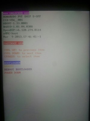

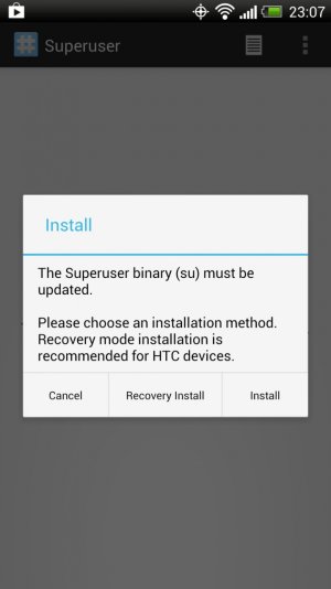

After s-OFF and unlock via revone, I have found that I am not rooted. I don't know where to go from here...
"Differences of habit and language are nothing at all if our aims are identical and our hearts are open.? -courtesy of Albus Dumbledore, via my droid DNA.

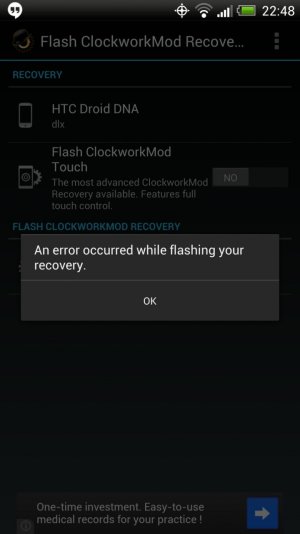

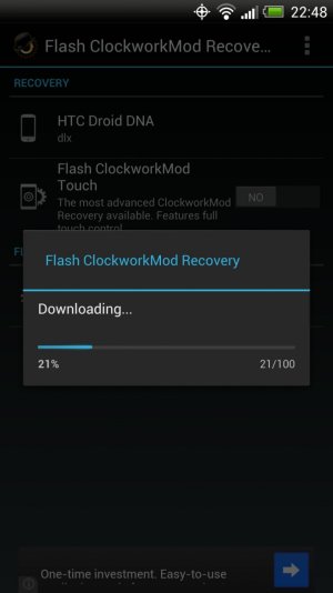

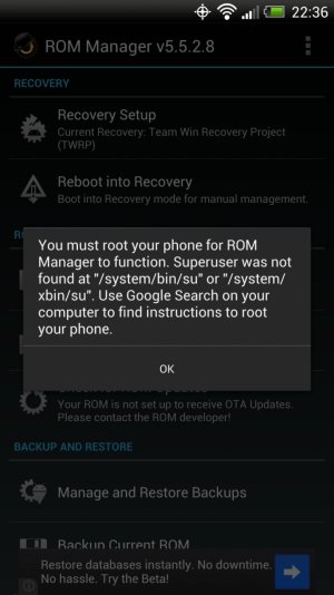

I can't make a recovery without being rooted, though. My bootloader says I am s-OFF and unlocked...

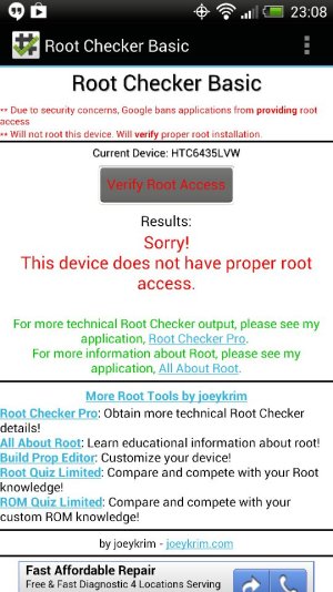

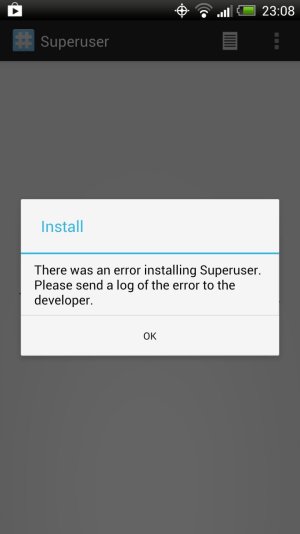

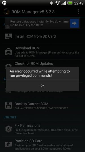

But root checker says I am unrooted, and I'm unable to use Rom manager or superuser because both say I am not rooted...
