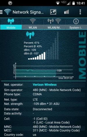

What is your 4g signal strength? I have really bad coverage. Usually my signal is about - 115 to - 120. Which is the biggest drain on my battery.
Feel grateful. The numbers I posted earlier are the biggest drain on my battery. I use to go 3 days easy, there are screen shots in the battery life thread. Now if I leave 4g on I barely get 12 hours.

I'm on track for two days of usage but I got a replacement phone (with a fresh battery) and I think some people may have batteries that are going bad if there are no apps that are secretly draining your juice. It doesn't hurt to go into a Verizon store and show them how horrible your battery is with proof of the results and try to get a free hardware replacement, it was easy for me to do at my Verizon store. Also I usually have a -107dBm or worse signal.

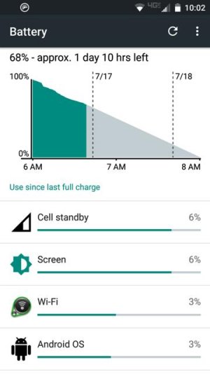

Anyway I'm enjoying my replacement:

A quick update on my Turbo battery life. After updating to Lollipop, my battery life dipped from 32 hours down to 18 hours. Performed a cache wipe a couple days ago and battery life is markedly improved. Charged battery this morning up to 92% and, after 5 hours 30 minutes (all on a weak 4G signal, limited use/mostly on standby), phone has 41 hours remaining. Granted, that is with about 3 minutes of screen-on time but that's a huge improvement over what it was. On standby I'm using just over 2%/hour compared to before the cache wipe where the phone was using 5.8%/hour.
