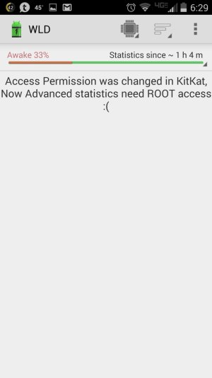

download wakelock detector too see whats keeping it awake

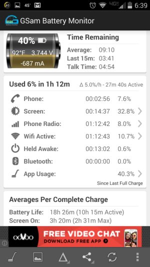

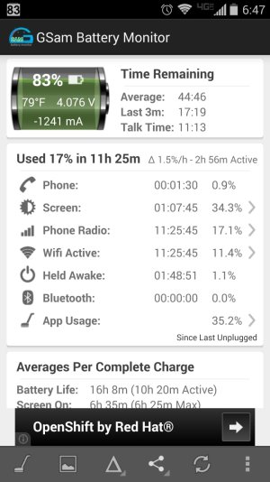

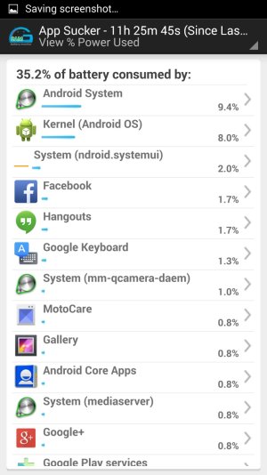

Here they are. Typically when I first open Gsam, my mA are 1200+. Pics I've seen here are much lower. Don't know if it is significant or not.

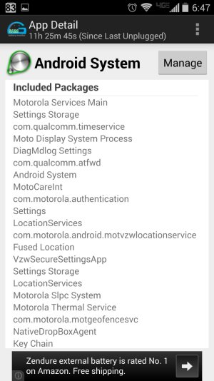

The android system is using most of the battery, which could be location settings, the moto active display, the wifi settings. all of that. So far what have you disabled? as far as settings

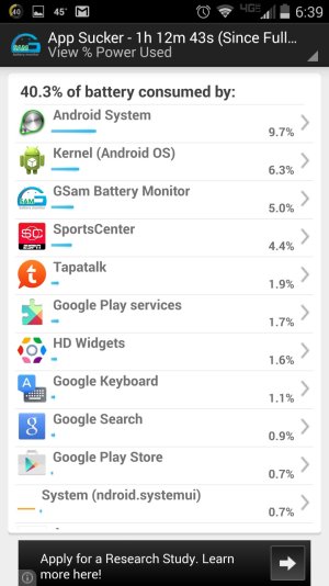

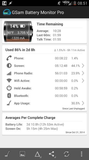

here's mine. Have you done any discharging cycles? and how long have you had the phone
Screenshot_2014-11-08-18-47-27.jpgScreenshot_2014-11-08-18-47-38.jpgScreenshot_2014-11-08-18-47-30.jpg
Holy smoke! How tbe heck are you getting times like that?! I've had it since 10/31. Haven't done any full power cycles - I'm on call a lot so I'm a little afraid of needing it suddenly. Lowest I've gotten is like 14%

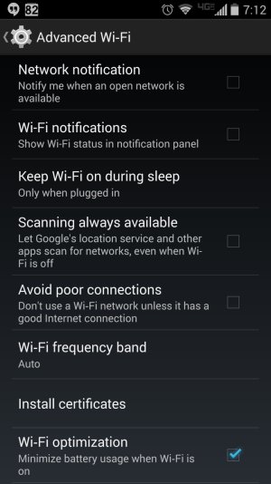

yeah eventhough you shouldn't have to comprise to get good battery. I've disabled location services, changed some of the wifi settings, disabled the account syncing, and the moto always listening and always on features. I've also done 3 or 4 full charging cycles. meaning using the phone as normal letting it die then fully charging it back to 100 without using it. I know there's been articles online about how not to let it discharge fully and some that says it doesn't affect it in a bad way, but I based it off prior knowledge and did the discharge and it actually helped. At first my battery was terrible too getting around 16hrs with 5 hours of screen on time and idle time was bad too
Thanks. I cant do without account syncing either unfortunaltely. I haven't seen any suggestions on altering the Wi-Fi settings. What did you do?

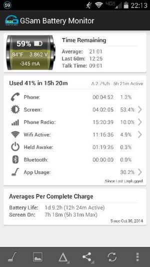

My battery just keeps getting better and better. 15+ hours of on time and 4+ hours of screen time... and still have 59% left!

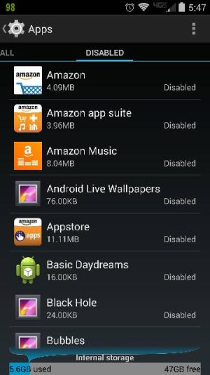

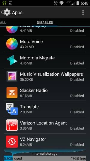

I am on a 32 hour battery pace and I'm pretty happy with that. I have 32 apps disabled. Also turned off the infrared sensors. That helped but I might go back to it.

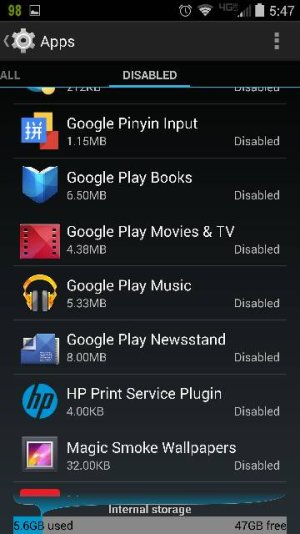

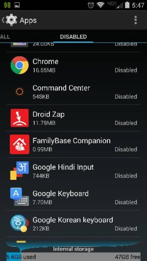

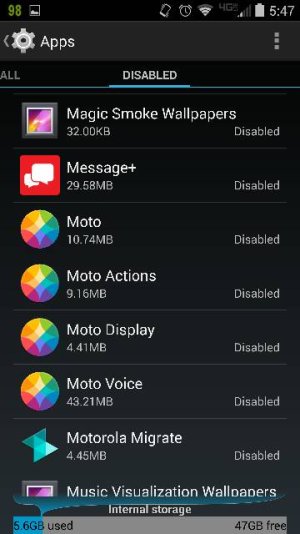

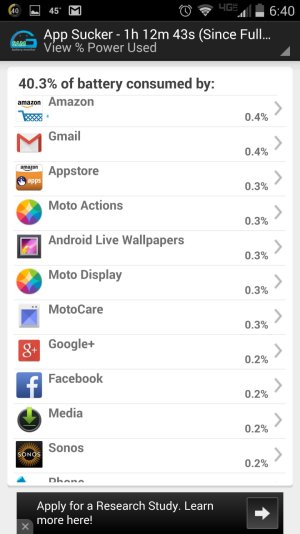

Here's my latest. I won't complain. Watched amazon video during train ride friday, played some games, used google maps for a trip saturday. Other than that general internet use, news and such. I'm pretty happy with it. I don't need apps syncing in the background and that saves a ton of battery. I use tasker to regulate it. I started with auromateit but switched. These settings are not for everybody.

I disabled command center, which I could care less about, in conjunction with a few other things, so although my battery life has improved significantly, I can't be sure what exactly to attribute it to. Is it a combination of everything, or is it one thing in particular, namely the command center widget? I guess, now that I'm done with the command center, I'll start turning other things back on to see if the battery remains as good as it is now. And if I turn them back on one at a time, then I'll be able to potentially pinpoint what's causing problems. The only things I disabled is: location (cause I can turn back on easily if I need it), the wave to silence, and approach to turn on moto display. I do like the approach to turn on the moto display feature, I'm not going to lie.
