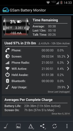

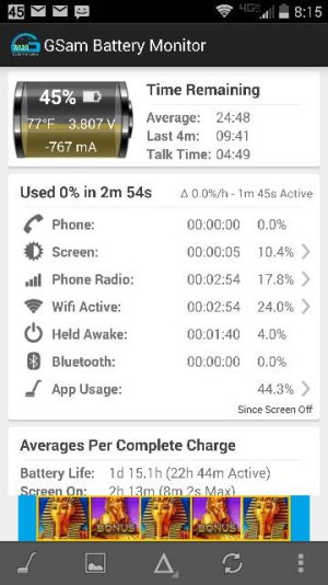

Try this : Before you go to bed, on Gsam menu at the bottom of the screen, there is a triangle. Tap it to set it at "since screen off". Set the phone down without touching it or moving it, and go to bed. When you wake up, go into Gsam and immediately take a screenshot. That should tell you what's been active while the screen is off and also shows you your % drain per hour. Post back here also with a screenshot of "App Sucker" (first icon on the left side of the Gsam menu bar) to see what's up.

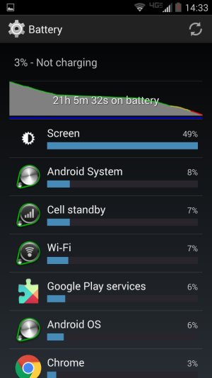

This was my real first full drain and recharge statistics. I manually set my screen to full low due to being indoors and then the next day adjusted the brightness accordingly for the brighter room. As you can see I was on my phone a lot! I wouldn't say I was power using ( I could have been doing a lot of streaming) but I definitely wasn't board over the past day either.
That Screen On time is outstanding !
Also Held Awake is very good.

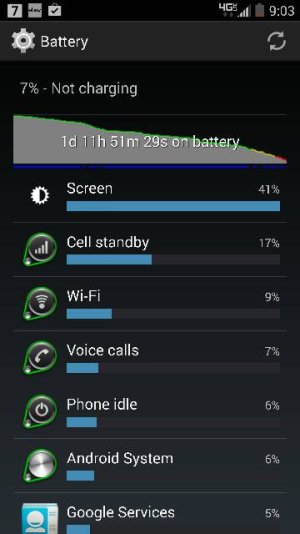

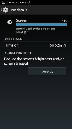

After a dismal first three or four days my turbo has finally come around...almost 36 hrs, just shy of 6 hrs sot.... Im a very happy camper!!! I decided not to plug in last night. So unplugged since 9am on Wednesday.

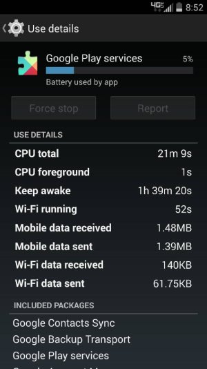

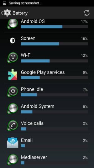

Is this abnormally high in terms of time awake for Google Play Services?

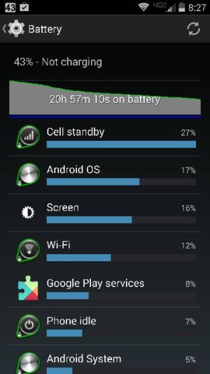

I also had a problem with idle battery drain the first few days of owning my Droid Turbo. I disabled the features that use the front IR sensors and front facing camera (Settings >>Display >> Attentive Display) and (Settings >> Moto >> Actions). Turned all that nonsense off, and my idle drain time went down. It's now another same level as my Droid Maxx in terms of idle battery drain.
OK. Here are m stats from over night. One other thing I did was shut off the IR sensors on the front so that phone wasn't constantly waking up.
jec11718, what did you change? I've been following this thread and saw your woes. Did you do anything different? Can you let me know what your settings are to get the recent battery time? Thanks!
