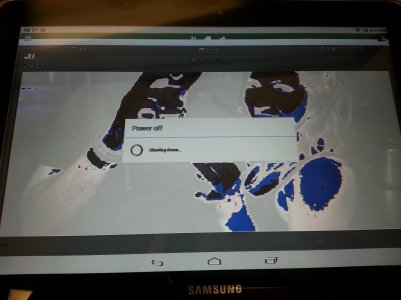

My tab 2 10.1 fell from my bed onto the tile. The screen did not crack, but now the colors are almost all inverted or generally just messed up. I'm wondering if there is a wire or a connection possibly loose that I might be able to fix, or will I have to purchase a brand new part in order to resolve this issue? Any help will be greatly appreciated!
Here's what it looks like:
Not cracked where you can see it? Or did remove the screen from the device to verify it is not cracked? I think it's probably cracked.
