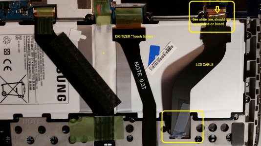

Similar problem. My daughter dropped her Tablet Note 10.1 and colours went as per image provided in the post. I looked into the far right ribbon (which actually controls the input to the screen. Mine was properly aligned at the connector (anyway, I reconnected it - just to be sure). However I noticed that the ribbon is folded and 2 sides of the fold need to touch (probably cross-over signal processing issues and Samsung found a dirty fix by taping those sides together). I secured the two folded sides with the masking tape and it worked wonders.

Had the same issue, with no real help or direction. So remove the back over, Start by removing the chrome cover it just snaps off. Under it remove 3 screws. Remove the PEN. Now from the hole were the pin slides in start to pop the back over by sliding plastic knife around in the gap, twisted as you go to pop up back just clips down. Now look at my pictures you will see the madness under. Both ends of the Ribbon cable have to be seated, look at the white line, one of the connections you can see because the cable is folded over it, hiding it. Good luck. This procedure my cause tooth decay!20160627_083913.jpg20160627_083125.jpg20160627_083249.jpg20160627_083303.jpg20160627_083325.jpg20160627_083414.jpg20160627_083529.jpg
I had this same problem and inverting the colours on settings did not work. I took it apart by watching a youtube video and i reseated the video cable at both connectors. I turned on the tablet before I closed it up to ensure it was working and realized I needed to keep my finger on the cable where it folded back in order for it to work properly. I just wedged piece of paper there and closed up the tablet. It works fine now. Hope you have the same luck.
Had the same issue, with no real help or direction. So remove the back over, Start by removing the chrome cover it just snaps off. Under it remove 3 screws. Remove the PEN. Now from the hole were the pin slides in start to pop the back over by sliding plastic knife around in the gap, twisted as you go to pop up back just clips down. Now look at my pictures you will see the madness under. Both ends of the Ribbon cable have to be seated, look at the white line, one of the connections you can see because the cable is folded over it, hiding it. Good luck. This procedure my cause tooth decay!View attachment 230873View attachment 230874View attachment 230875View attachment 230876View attachment 230877View attachment 230878View attachment 230879

I can't believe the answers I'm reading here. You cannot change the settings by dropping the tablet. You can knock the cable lose to the LCD or damaged the LCDs like the one pictured above. I am replacing mine for the second time after dropping it. There are videos on YouTube that show exactly how to disassemble and replace it. For my Galaxy 10.1 n8013 I found a new LCD for $15. I find it irritating that people that don't know the answer post the guesswork.
