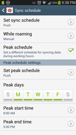

I have my work Exchange account set to only push during the days and times I set. Even though this is enabled, I continue to get notifications regardless of the time or date.
Any ideas? Thanks! :)

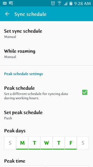

That's because you have the overall setting to "Push" as well. The top option - "Set sync schedule": set that to manual. Then you'll be able to push during peak hours, and manual during off-peak.

Thank you, RG129. I made the change and will see how it goes in the morning.
Thanks a bunch!
Thank you again. It's been working perfectly! :)
