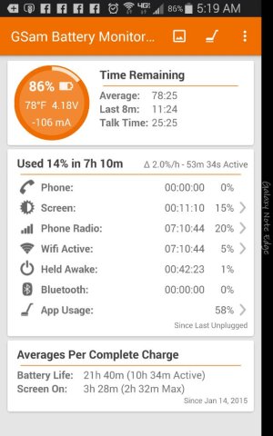

Non factor for some. It is an issue for me currently. On the Note 4 that I had for 2 weeks, I'd only drain 4% on standby from 9 pm to 4 am. On my Edge, I'll drain 15% in the same time frame. I would love to get similar performance on my Edge. I don't have a flip case on my phone, but this Cocktail Bar seems to be one culprit.
Just because it's a non issue for some, doesn't make it a non issue for others.
That said, I love my Edge and will continue to try to figure out how to optimize my battery life without crippling the device.

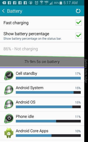

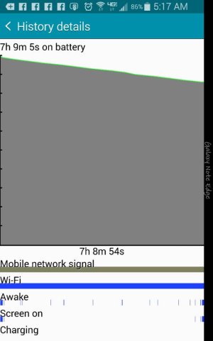

Yes, they are configured the same. Last night, I made sure that location services and Bluetooth were turned off (I never had to turn them off on the Note 4) and I used Greenify to hibernate out of my apps.
So, last night was the first time I tried doing something different. But results didn't change. They have the same new SD card in them.
Here are stats when I got up this morning.

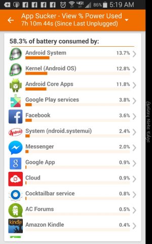

During that time the edge panel was only good for less than 1% of the overall drain. So it isn't the edge specifically but maybe the edge is handling background processes differently than the Note 4 but I wouldn't think so. They're basically the same. If it were the edge panel though I would tell you to check the screen time out on the edge panels but other than that the edge panels when not in use shouldn't be making much of a difference. All the edge is is basically a vertical dock and widgets feature. Battery consumption would be based on what is running not what is housing them, especially if it's not being used. So if the edge is timing out properly and it isn't being activated then it itself shouldn't be pulling your battery much.
Looking at the stats your battery consumption split 42% to core functions (phone radio, screen, etc) and then 58% to app usage (even though some of those apps aren't apps, they're still essentially core functions). Anyways just for comparison the edge panel consumed .8 and Facebook and Facebook Messenger accounted for 5.6% more than 5 times the consumption. So it's not the edge. It's something else. At least I think. I'm sure cocktail bar service isn't the only edge resource but still it's negligible to everything else.

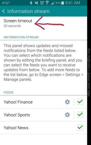

Well, I had it set to 2 minutes, so changed it to 30 secs just now. See if that helps.
