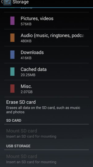

I have searched about this issue with my SD Card slot on this site, and am turning up with problems with non-rooted phones.
My phone now is fully S-OFF'd and running BeanStalk-4.3.075, and is very smooth. Before rooting, the slot worked fine with 2 different cards. I have flashed 5 different roms and sd cards on all relevant formats, and they all have the same result: the SD CARD SLOT NO WORKIE!

I just flashed meanbean, and I get the same result. I also relocked my phone and returned it back to stock ICS using the RUU and no sd card would be recognizable still.
I've realized that something must have happened when I rooted for the first time. Voltage spike maybe? I'm convinced it's the hardware...

I found that the 3.17 firmware was out so I decided to place the PJ75IMG.zip on my sd card. HBOOT recognizes my card, but the OS and TWRP do not! Weeeeeiird...
Has this happened to anyone else? I cannot see the sd card in any explorer app, nor the latest TWRP recovery.
