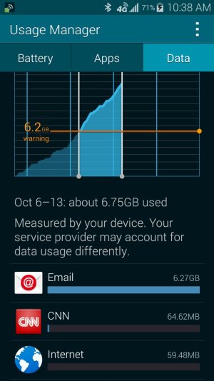

In the last month or so my S5 email has been killing my battery and drawing huge data. My emails are generally text emails with maybe one or two a day that need a document or photo downloaded. My emails are just personal emails through Bellsouth.
I've looked in the outbox for a 'stuck' email and I've looked for photos that could be getting downloaded continuously and there aren't any.
If you run the phone with background data turned off, it stops the excess battery drain but the phone is about useless in that mode.
FWIW The phone is showing constant data transfer whether on WifFi or 4G. I've had the phone for about 4 months and this used to not be an issue.
Any ideas?

Seems massive amount of data is used by your email. But it's only showing 9% in battery stat which is weird. Does com.android.systemui come from emails too or something else?

I couldn't tell you what its for and it seems relatively new on the usage chart. I've been googling it as well.
- something is definitely wrong, have you try to reset your mailbox ?
It's like if it was downloading each mail more than one time...
com.android.systemui looks hungry too...

Wow! That's a lot of data. You could try to check if there's something wrong with the app or with your email account. First thing could be clearing the cache for the app, force stop (or even disable it) and open (enable) it again.
If the data usage persist after that you could try to manage your emails from a different app for a couple of days and see if the same problem is still there. That could be a sign of something wrong with your account.
I just cleared the email cache....6.5MG(!) and uninstalled then reinstalled the email app. Looks promising so far.
