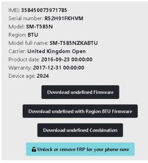

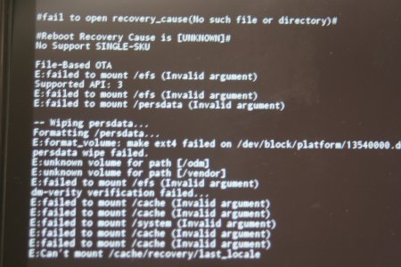

Hello folks - sorry to bother you, but Android is a bit of a mystery to me - I can build a windows PC from scratch with no bother, and I can write a whole website in HTML code on Notepad, but my 70 year old brain just goes "flip-flop" when I try to implement the fix for what appears to be a pretty common problem!
In a nutshell, I have before me a Samsung SM-T585 A6 tablet that looks to be stuck in some sort of "boot loop"
The screen flips betwen 2 states - one showing little robot logo and "installing updates", the other with lines of text beginning with the fateful words "#fail to open recovery - cause (No such file or directory)#"
I have downloaded Odin and Frija onto my PC, connected tablet to my PC and was hoping FRija would tell me what CSC was required (presume that is the required firmware bundle???), but it just says "error; please specify csc"
Clearly I am being a bit thick, and expect friendly insults along those lines, but if somebody can please give me id1ot-proof instructions on the exact steps to take, I will be most grateful.
Hi welcome to AC!
Since it says united kingdom open I would use the more popular CSC BTU
Thanks for that - I am still left with 2 problems
1. Finding a trustworthy download site for CSC BTU - preferable free - anybody?
2. Tablet is still stuck in the same boot loop as described previously - I have opened it up, tried disconnect/reconnect battery (no joy) and found battery voltage is down to 2.9v - so I have ordered some miniature test clips to allow me to attach a Li-Ion battery charger directly to the battery. If I can get the battery up to correct voltage, I understand I may stand a better chance of success with the 3 key startup routine - all advice welcome on that sunject too please!
many thanks!
Hey All,
Having all of the above problems with my Samsung A5 2017. Downloading do not turn off target, won't restart is on a loop. Won't enter recovery mode, then flashing between system update and about the cache. Have downloaded odin and frija but no clue what to do next. Thanks for all the support so far. Very grateful and would love to be able to hold on to the data which hasn't been backed up. Any help very much appreciated x

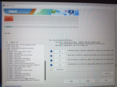

Hi, can you show a screenshot of odin with files in it ? Make sure your in download mode try different cables and usb ports in computer
Hi @Mustang thanks very much for getting back and for all the tips.
I've attached a picture of the screen?
Hopefully it has attached.
Many thanks
Hi @Mustang,
Just an update on my previous reply to this message...
Changed USB port, download mode and it said added, odin ending, setup connection, initialisation, rqt_close!!, res ok!! removed!! remain port... 0 , all threads completed succeed 1 / failed - it says pass and went to restart but it is back to blue android installing system update to #fail to open recovery causes no such file or directory.
