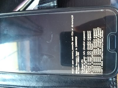

It isn't going into recovery... just flashing between screens like before...
Attached is pic of one screen that comes up on phone. This flashes intermittently with the blue android system installing update

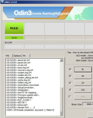

I used Odin and got the following results:
This was with HOME_CSC and all other files (BL, AP, CP)

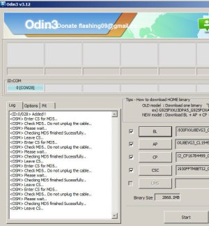

I tried to upgrade with the CSC file:
MD5 verification is ok

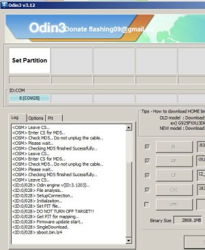

But the process gets stuck on this screen
I stayed on this screen during 1 hour without result.
