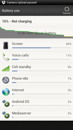

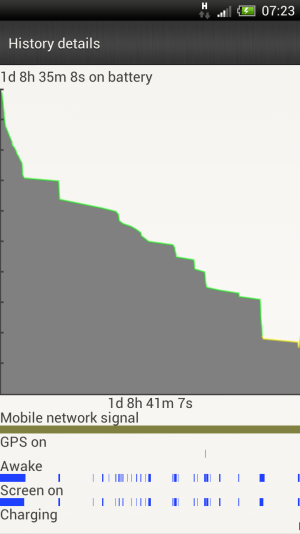

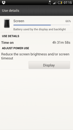

I just have push notifications for fb. No live wallpaper. Auto brightness. I got 19 hours yesterday though with significant wi fi time
this time wifi was off. 3g data connection.5 email accounts,internet,text and phone. the big drop at the start was watching tvcatchup

sadly yes. The lte radio as fast and glorious as it is. Is like a v8 With a 12 gallon gas tank. Not gonna keep the motor running long.

GPS on?? That's a major power draw
Sent from my HTC One X+ using Android Central Forums
Gps is not a major power draw.
Its a receiver. It doesn't transmit. It takes virtually zero power. Mine is never off.

Ok see I rest my case. it is also a radio it sends data to ping off the satelite to get an accurate location. Ok do this go down the road with navigation, and no charger take a 20 minit ride. see how fast your battery takes a death plunge.

The gps does none of those things.
It's a receiver. It doesn't ping (what ever the hell that means).
It listens.
