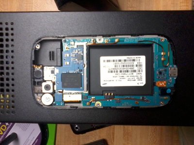

Check out the pics. One of them shows some solder on the silver shielding so it makes better contact with the connector when they close back up. The other shows a 30 gauge red wire soldered to the gps pin and running down the phone. Hope this clears up what you guys need to do to get the gps to finally work on this dag gone phone. I don't know where all the people are who complained about this issue, but this fixed my phone. When I searched on Google, there were non stop posts of Navigation problems.

I managed to improve my cell service issues after manually updating to PRL 60690, but I've still been investigating a similar mod to modify the 3g/4g/Cell antennas.
I found out that the phone has external antenna ports, but using them causes the internal antennas to burn out, requiring a replacement phone. I've circled them in votageROCK's picture below: The WiFi antenna is circled in red, the 3G antenna in orange, and the 4G antenna in yellow. There is also an external port for the GPS antenna, but votageROCK has already shown us where the internal GPS antenna is (the internal connector and external port are right next to each other).
I've assumed that the gold posts (like the one votageROCK soldered his wire to) nearest to the WiFI and 4G antennas are their respective internal antenna connections.
I believe the 3G and cell internal antenna connectors are near the bottom of the phone, circled in white. I don't know this for sure, but that is where they're located on the GSM Nexus S.
The antenna connectors circled in black are unknowns.
Very good work, but I wanted you to know you are correct in that the gold springy posts are the ones that attach to the antennas.
Like I said in my OP I found out which gold spring was the GPS by putting a piece of electrical tape over every gold connector that touches an antenna and leaving one free to make contact, then closing the black cover, turning on the phone, running gps test, and after trying different spring connectors until I found I had the correct one when the app GPS Test couldn't locate any satellites. Just an FYI again.
Also, you are correct about the bottom of the phone for the antenna for the phone's cell and 3G. The 4 noticeable ones when you take apart the cover or if you look in my pic are GPS (the one with the red wire attached) and the other 3 must be WIFI, then Bluetooth then 4g (but I'm not sure what is what, but someone can certainly do the method I did to find out what's what with the electrical tape and seeing what doesn't work when you turn the phone back on. I'm not positive about WIFI and Bluetooth using different antennas and may use the same antenna because a friend of mine said that those two use the same frequencies, but I personally don't think that's correct. The 4g antenna I would have thought was at the bottom with the 3g and cell. There are three gold connectors down there. I forget if you can see that in my pics.

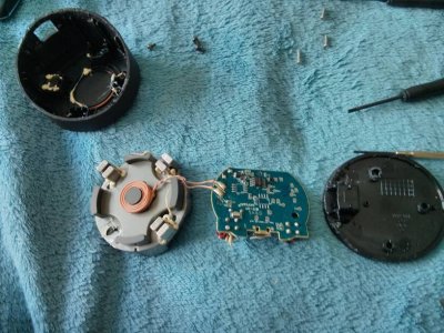

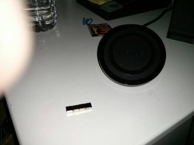

I'm working on the Nexus 4 Orb working in the car. Dismantle the touchstone for the magnets and use the metal discs from the inside cover of the Pre battery cover. You need to file the four magnets from the picture and grind them down to approximately 1 mm thick and fasten them to the Orb and the Nexus will stick to the Orb perfectly and will charge with the Orb in the car. I'm almost done with my project. I can't wait to have access to a belt sander to do this!
