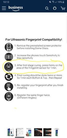

Just make sure you apply the pressure around the FPS sensor for a minute like in the directions on Amazon.

This direction when u look up Dome on Amazon
