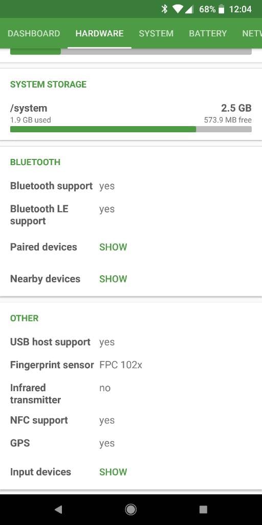

You could try something like DevCheck https://play.google.com/store/apps/details?id=flar2.devcheck - it should at least show that the fingerprint sensor is present.

Shows the sensor and it's there along with a factory reset but no luck. Still acting like its not turned on
