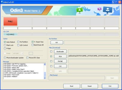

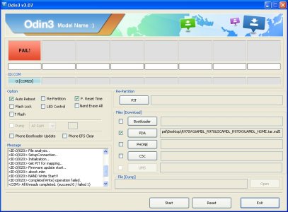

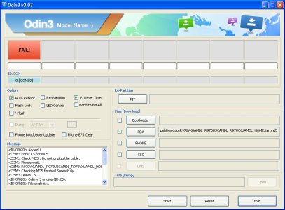

Looks like I got myself in a pickle. I have a R970 GS4 on US Cellular running 4.2.2. I picked up my phone today and successfully rooted it with the following method [http://droidviews.com/2013/how-to-root-u-s-cellular-galaxy-s4-sch-r970/]. I then installed CWM recovery with ROM Manager and backed up my ROM with it. I decided to replace chainfires SU with the one fom CWM like I had on my S3. After rebooting from recovery mode I noticed I had lost root so I used the same method to root it again. On reboot the error ?Firmware upgrade encountered an issue? along with a cone and a couple of other pics. Before the reboot occurred there was option to prevent the possibility of the ROM flashing itself to stock. I went to select the Yes option but bumped the power button which selected No.
I have tried to get into recovery mode several times but repeatedly get this error. I can get into download mode and have tried to flash the stock ROM for this phone but it fails in Odin 3.0.7. Odin sees my phone and verifies the md5 but fails very quickly upon clicking start. I tried this with KiesPDLR running in the background and disabled. I have not tried anything else out of concern for messing it up further.
Attached are screenshots and log from ODIN along with the text that is being displayed in download mode. (I will have to post these later as the attachments option will not work properly on my wife's S3).

Attachments have been uploaded as mentioned from my first post.
Two other things I forgot to mention. The first is a message that appeared on the phone when I tried to reroot the phone and failed. It read "Invalid percent of drawing download progress bar." It never did anything after a long while so I reluctantly disconnected the phone and tried to restart the phone.
The second is that I used ODIN 1.85 to root as that was what was included in the chainfire download. But I used ODIN 3.0.7 to try and unroot because that's what the DroidView directions said. Would it make any difference to use ODIN 1.85 to try and flash the stock firmware? It sees my phone as well but the F. Reset Time option is unchecked and grayed out and the directions says it needs to be checked. Don't know if that really makes a difference.

I am back in business. I have my phone and home internet back now. Yeah. I used the same stock ROM I had since it was the same as sammobile and I already had it on my system. I just used Odin 1.85 instead. I guess I could have done this earlier and prevented a near stoke but everything else I had done seemed to get me deeper in a hole. So two follow up questions. Why would it flash with Odin 1.85 and not with 3.0.7? Is CWM's SU not compatible with the S4? Everything was working fine until I switched this from chainfire to CWM using ROM Manager.
Android_S4
Aug 13, 2013
10
Visit site
Oh you fixed it already. It wouldnt flash via Odin 3.07 probably cuz the firmware you had is older than the Odin version... I downloaded a firmware released in july 23rd and it wouldnt flash via Odin 1.85, as I tried with odin 3.07 it flashed like there would be no tomorrow, quick and smooth.
