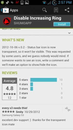

FYI i asked the dev to make the statusbar icon transparent and the update is released today.

I bet I know who posted this
Seems good. Can we use the Jelly Bean option to hide notifications for it? Would that keep it in memory or not?

yeah, you can. I rebooted and the increasing ring is still disabled.
