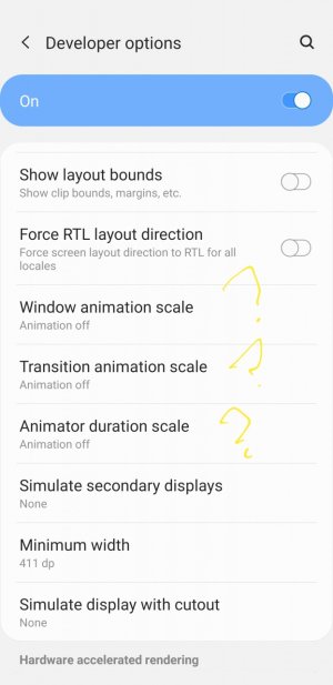

Change animation settings in developer options. Change animation duration scale to .5. I had same issue and this fixed it for me.
Thanks guys for the solution. I have note 9 and Googled and found this solution.
You can leave first two at 0X. It's "animator duration scale" that needs to be at least .5X to stop the flicker.

SOLVED for Note 9 with Pie update:
The solution for the Note 9 is not quite as noted above - there are no animation settings in the developer settings area, instead you'll find it here:
Settings --> Advanced Features, turn on (make blue) the slider for "Reduce Animations".
