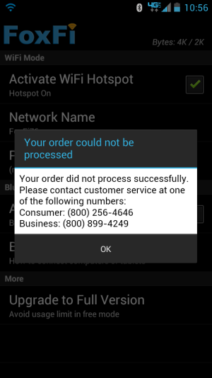

This is the message I get when I tried to use FoxFi on the latest update (98.72.8). It is the same message you receive when trying to use the Verizon Hotspot without a subscription. On my Razr MAXX, FoxFi does NOT work with the latest update.
