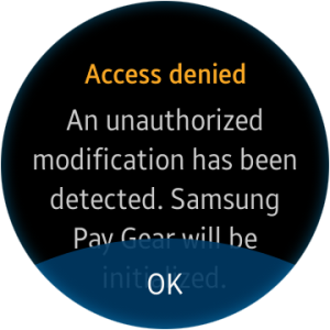

So, since my problem is not about my firmware version, I contacted Samsung Support. Wow are they unhelpful. Email and online chat both had absolutely no clue. The Samsung Pay support phone person insisted that Samsung Pay so far only works on 3G watches, not on bluetooth ones. I had to shout a bit and offer to send screenshots of Samsung's own statements to the contrary to get her to believe me. And then all she could think to do was send me to the "Samsung Experience" section of a local BestBuy, where it sounded like they'd just start doing random hard resets and firmware updates -- which I can do and have done myself. Ugh.
So I need the wisdom of the crowd: Anybody else trying to use Samsung Pay with a bluetooth Gear S2 and Samsung Note 4? Anybody else getting a "Gear not responding. Try again" notification when trying to set up Samsung Pay Beta? Anybody else seeing this?: Screen-20160722105434.png

I have not seen an update on my BT S2, but thought I'd give the Pay beta app a shot. It installed on my phone, said the watch needed an update and went ahead and installed that. I am not seeing some of the stuff listed in the firmware upgrade, but Pay beta is working fine on the watch.

Contrary to your post above, you do not need the value pack update to use Pay beta. You also do not "find" it, it has to show up as a banner on your phone's Gear Manager. That app loads your S2 BT.
