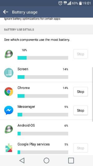

It's true. I get around 30 min less screen on time, and I've had it for around a month.
Also what's up with that 6% on battery usage?
