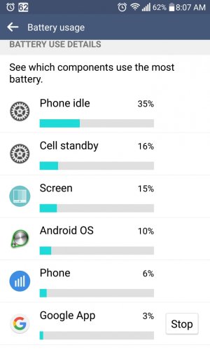

G4 battery is worse on marshmallow.
Sorry for posting twice. I tried to put two images, but it uploads only one. No, it's not rooted. H815T unlocked, running MM.

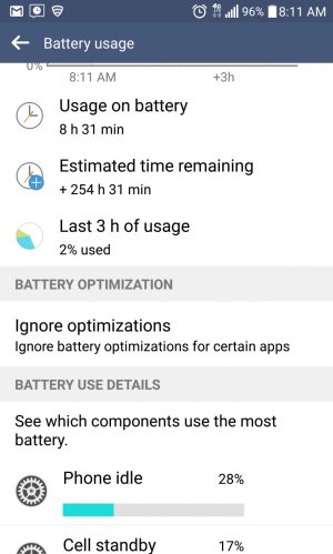

Interesting news, battery performance has returned to pre-Marshmallow level!
I tried turning off Sync, but it made little difference, and I sync lots of stuff. Many email accounts and all the Google stuff. Next I disabled (when available) or uninstalled every app that I infrequently use. Unfortunately I don't know what the "bad" ones were - but there was most likely some kind of memory leak. I'm back to not having to swap batteries every day! At the end of the day - 11PM or so I still have around 30% left. I can live with that. Under 5.0x I had more but this is good enough. As a test I start off with a battery charged to 100% just before I go to sleep and the next morning see how much is left.
Here's before - from 100% to 62% overnight:
And after - from 100% to 96% overnight:
I conclude that apps that aren't well behaved under Marshmallow are the cause of much of the battery woes. Factory reset also helped - but removing the apps made a much more significant difference. I was able to get rid of apps I didn't need. If you absolutely need some apps that are not well behaved, the only thing you can do is wait until the app developer improves things on their end or the next system update improves things.
I haven't had to use my spare battery for days. Of course if you have an app that is essential and is killing the battery under Marshmallow - no solution for now. Almost 11AM and at 97%. It's like having my phone back!

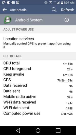

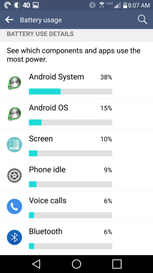

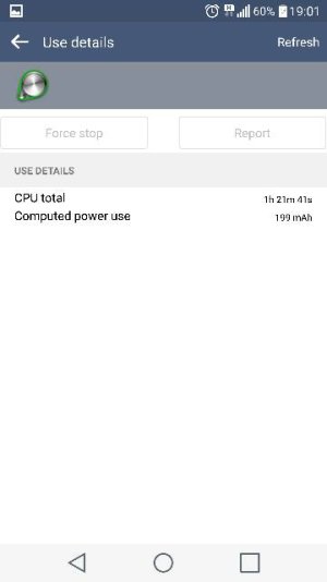

I had pretty good SOT and very good battery performance......prior to the last OS update a week or so ago. Now the Android system is sucking most of the battery life.
Below shows phone data 30 minutes after I woke up from a nights sleep. Prior to that it was barely used from the full charge the morning day before. I saw after being on yesterday the GPS was pulling about 3/4 hours and I did not have it on.
Checked apps I use often and none had permissions to use GPS except weather app and google services or something. I usually keep the GPS set on battery saving mode....but every time I turn GPS back on....it defaults to "High accuracy".....WTF What could possibly be defaulting the GPS to use the high accuracy mode after I set to battery saving?
You can see the GPS was in use for several hours during my sleep time, because it only had about 4 hours of use prior to me going to sleep where I again made sure gps was off and it was on battery saving mode.
