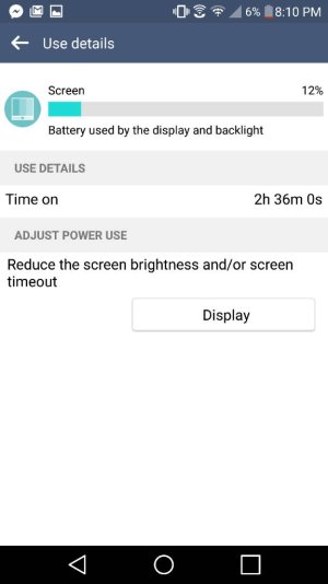

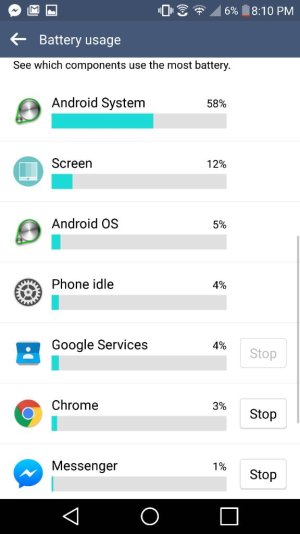

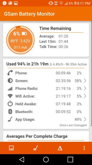

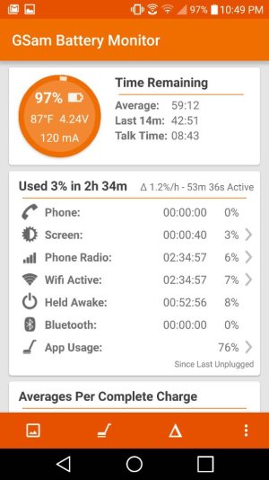

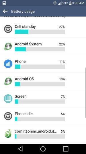

I have constant wake lock and1435561720353.jpg1435561720353.jpg battery drain from android system. It is using around 50% of my battery life. When my screen is off it is 100% of the time in wake lock according to gsam. I tried a reboot and battery pull and I'm still getting the same. If anyone could direct me to something that will find the wake lock or if they know how to stop it, it would be greatly appreciated. Luckily my 2nd battery is helping ease this terrible battery life.
Thank you!

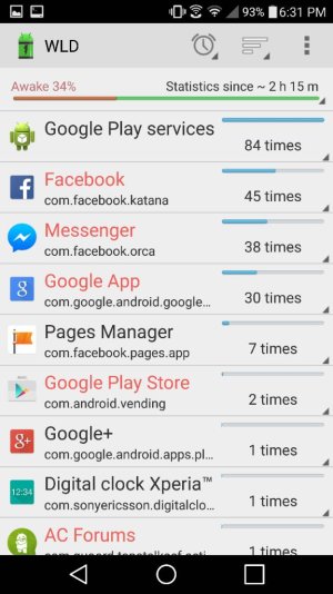

I have the exact same issue (on Verizon). I am going to give Wakelock Detector a try. Until then, I have become nearly certain that my home WiFi router is the biggest issue. This morning I reserved the IP addresse for my G4, and all the other devices on our home network, as suggested in an older online discussion I saw regarding this issue. In turning on the WiFi on the G4 briefly, the wakelock issues in Android OS seemed to continue. So the IP reservation didn't seem to help.
I'm going to split the WiFi issue out to its own thread, given it's a specific problem in and of itself.
"Android OS," Wakelocks, Battery Drain and WiFi
Well, after several days of reinstalling a few apps that showed an issue I thought might suggest a deeper problem (i.e. not pushing notifications when it should be), and some trial and error things (i.e. shutting off Verizon Advanced Calling 1.0 a.k.a VolTE), I am all but certain that the Android OS issue with out of control keep awake times is the fualt of my home WiFi router.
Now, I don't have any obvious performance issues otherwise, but switching off the WiFi, or leaving the house, has seemed to slow the Android OS keep awake times to a crawl...until I reconnect to the home WiFi. I am generally not fsr from the router when at home, as well.
I'm going to try out Wakelock Detector to try and confirm this even more strongly, but I am 90+% sure the WiFi router is an issue.

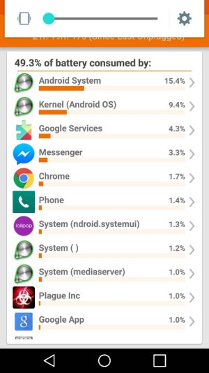

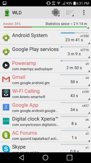

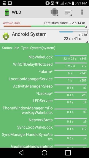

I think I found the culprit for me: nlpwakelock
Now I have to figure out how to stop it.

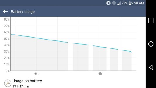

Play services? Try turning off smart unlock. I talked about in another thread.

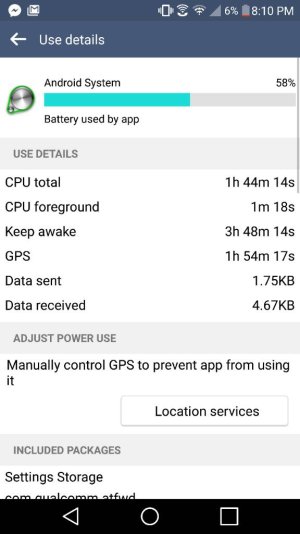

I disabled Google Now and stopped the location tracking. Turned my location to battery saving as well. My standby battery drain was even worse this time and I had strange gaps in my battery graph.
