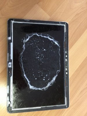

Ok. So I have the SM-P600 (2014 edition) with a cracked digitizer. When I ordered a replacement, i figured it'd be like every other tablet I've repaired and it would be a simple enough swap. I didn't know that the digitizer was actually attached to the LCD itself by adhesive. I thought if I went slow enough with enough heat, I could separate the two and use my new digitizer. I was wrong. After I finally got them apart, the LCD was cracked.
I dont want to have to order an entire screen assembly if I dont have to. (They're kinda pricey.)

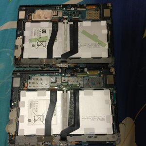

The top one is Wifi, the bottom is LTE, they're almost identical except antennas and SIM slot

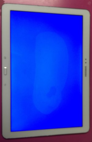

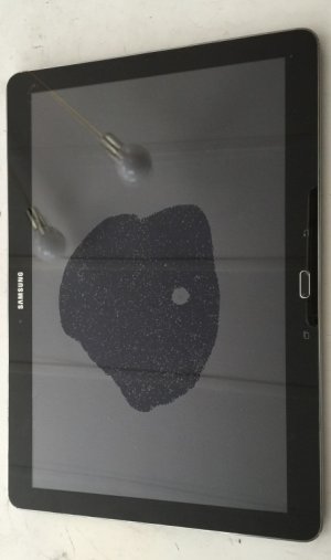

You can buy the LCD only for this model, but without LOCA ( Liquid Optical Clear Adhesive ) your screen will have a big dark spot like this
When the screen is on, it will look like this
A big screen like this it's very difficult to apply LOCA evenly without air gap. Without using LOCA, it takes me at least 3 to 4 hours to complete a replacement of a LCD or touchscreen .
Cleaning this glue is not a quick and easy task if the LCD is working and not damaged.
