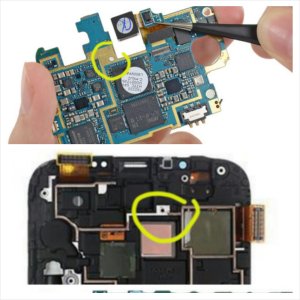

This is humorous because I have been squeezing and tapping my phone for months now with no true fix for the sound.. my note 2 cuts out and fills the music with static with all different headphones, audio plugs and even a new headphone jack!? Anyways, a slight pinch around the headphone area clears it up every time.. I have been in my phone 6-7 times looking for the obvious to no avail!!! There has to be a simple grounding issue here guys! Lets nail this asinine issue before we naw our teeth to nubs and start cursing this AMAZING PHONE lol..
After my earlier rant I opened my phone and have managed to fixed my knee smacking problem. The problem was a bad ground between the screen and motherboard. I have added a picture of the two metal surfaces I cleaned (circled in yellow) to get the good connection back. These are not pics of my phone because it was apart obviously but it is the same phone. My sound is 100% crystal clear:cool: I believe the problem comes with dropping the phone and the connection going bad due to lack of enough screws in the area of the connection. I also ran the screw directly into the motherboard instead of through the plastic backing in the same area I circled. Stop smacking you're phones!!

FANTASIC!!!! and 100% correct...fixed my phone in 2 min.took the back off the phone and noticed a screw missing from the hole you have circled...took the screw off the bottom corner and put it in the ground hole and my phone works perfect again. thanks for the info and your right....STOP SMACKING YOUR PHONES!!!!!!!!!!!!!!!!!!!! :-$
Thanks for posting this. I am having the exact same issue with my phone. I opened my phone and tried cleaning this area with rubbing alcohol and connected the screw straight into the motherboard. However I am still having the issue. I noticed that putting pressure in that area once the phone is all buttoned up again I can get it to reconnect but it takes some time and it goes out again if the phone is moved (in my car or pocket or something). Is there something else I should have used to clean the connection. Or maybe something I can use to improve that connection.
