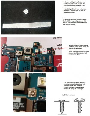

Don't beat on your phones!! I had the same problem, along with horrible GPS reception. I saw the post about the missing screw, and looked inside mine - the same screw was missing, just below the camera. I moved one of the side screws to that location, and tightened several others that were loose. Works like new now!!

I know this is a old thread but its a grounding issue. I just fixed my old note 2 a couple days ago I wish I'd taken pics...Anyway
Dont go putting tinfoil under the screw head by the camera like Ive seen on other posts. http://i.imgur.com/v6TwpZG.jpg that'll put pressure on the motherboard pushing it down. What you NEED to do is take mobo out and either build up the ground with solder under the mobo where its not getting a good ground right beneath that screw.

After my earlier rant I opened my phone and have managed to fixed my knee smacking problem. The problem was a bad ground between the screen and motherboard. I have added a picture of the two metal surfaces I cleaned (circled in yellow) to get the good connection back. These are not pics of my phone because it was apart obviously but it is the same phone. My sound is 100% crystal clear:cool: I believe the problem comes with dropping the phone and the connection going bad due to lack of enough screws in the area of the connection. I also ran the screw directly into the motherboard instead of through the plastic backing in the same area I circled. Stop smacking you're phones!!
