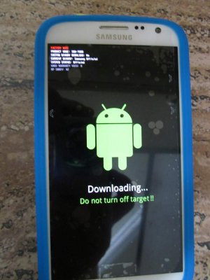

The Android guy showed up twice on my screen since Android 4.3 was installed and the battery draining so quickly is a problem too. This graphic shows up with the power off and no phone or wifi service. Not sure how it gets there.

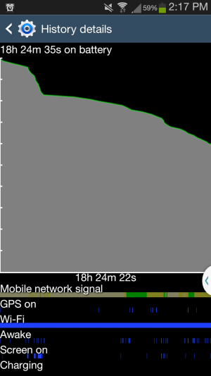

Did I just get lucky? My battery performance has been pretty solid since the day I got the phone. I took the initial 4.3 update last year, but blocked the most recent update, and I haven't noticed a change.
The attached pic shows my typical drain curve, I use the camera a lot, stream music, play games, and constantly text. You can see a big drop when I was playing games early yesterday. I usually get 1.5 days with heavy usage, sometimes 2 full days.
