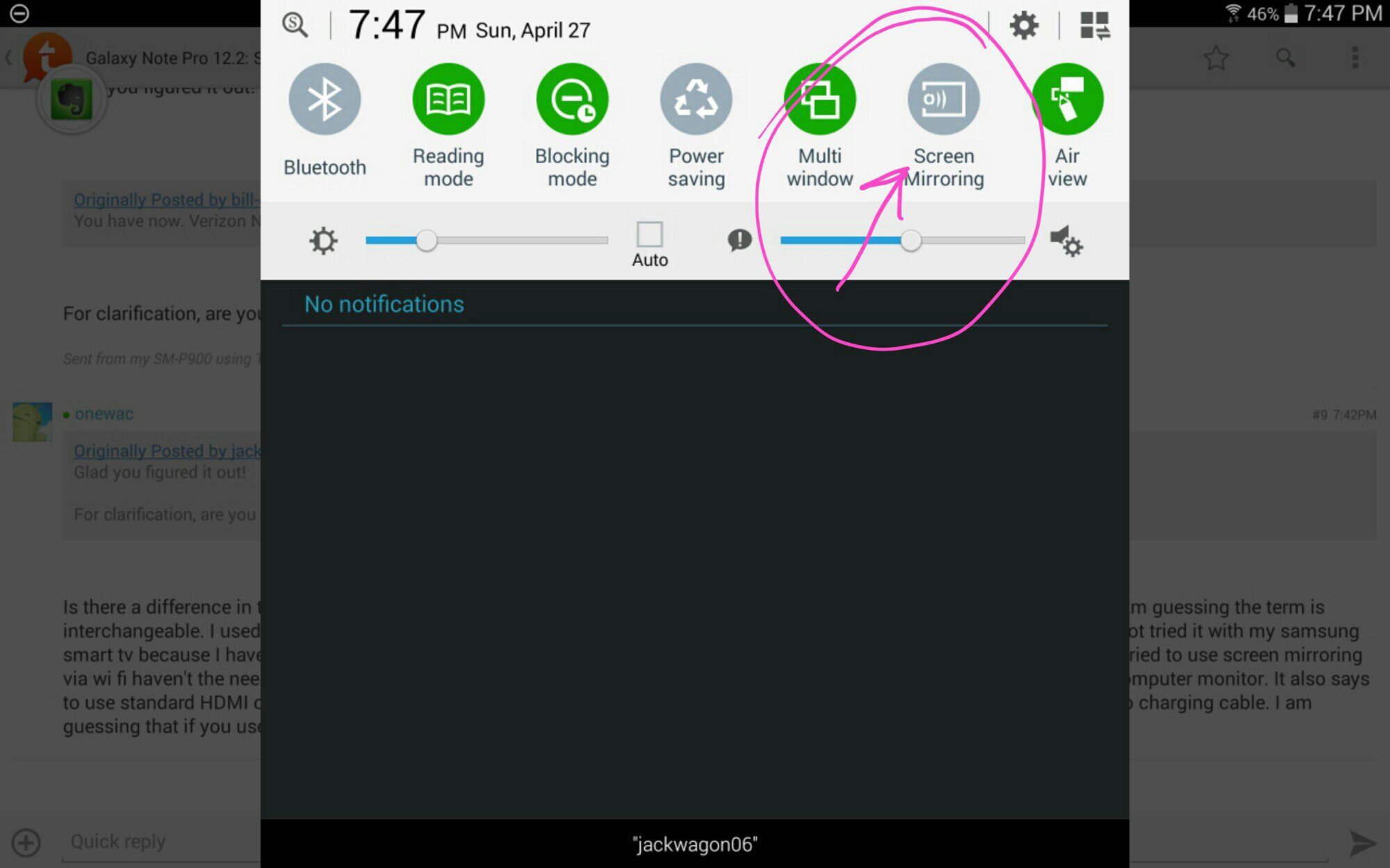

As you can see, screen mirroring is an actual feature of our tablet. This particular function is used wirelessly to a samsung dongle connected to your tv. It is connected via hdmi. It basically takes the place of of your cable. So yes, the term can be interchangeable. However, I also have the mhl adapter, and it does not work on my Vizio, but any samsung tv in the house works fine. Yes it will drain the battery.
