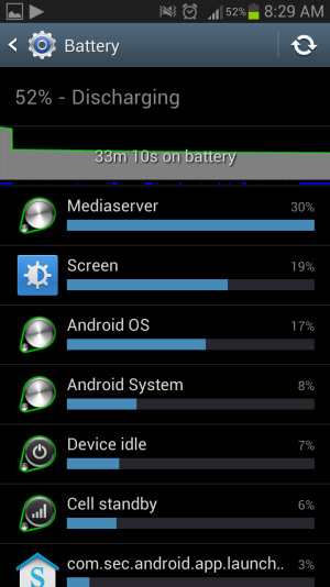

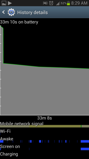

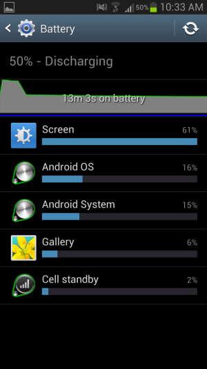

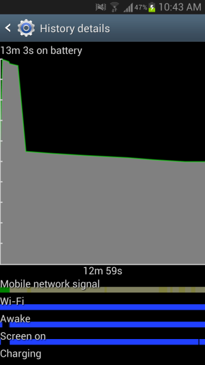

I had my Galaxy S3 for about 10 months and I started having problems with the battery couple days ago. I would charge it overnight and I would unplug it in the morning with 100% battery. Then when I check my phone about 10 minutes later, the battery would be at 60-50%.
I checked the graph under battery in settings and it would show this huge drop. But after the drop, it would run normally for the rest of the day.
I have no idea what's happening, and please help!
