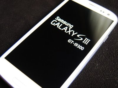

I received the notification there was a new software update available(I assume it is the 4.3 update) so i went ahead with the update. The s3 was on charge so no problems there.
The update started and went to 100% and then the device restarted and now it is frozen on the Samsung start up screen. I have tried a reset (power button and home button) but this did not have any affect the Start up screen remained,i tried to boot the phone is safe mode(power home and vol up buttons) and this did not have any effect either.
I pulled out the battery to restart the phone and it still remains frozen on the samsung start up sceen.

I'm pretty sure this is exactly my case. After downloading the 4.3 upgrade from (4.1.2) via software update in the Settings menu, when rebooting, my S3 got stuck in the booting stage, that is, the Galaxy S3 black screen. See below. After that, nothing happens. I've waited for 4hrs after the reboot but nothing happened. I tried removing the battery (and SD card & SIM card), and powered the device on, same state.
Here's how it looks now....

Finally, the solution! I made use of Samsung Kies. Here's what I did:
1. Install Samsung Kies in your computer if you don't have. (You may have to choose between Kies or Kies3. Kindly check Samsung website)
2. Connect your device to computer.
3. Turn on your device. As with our case, it will get stuck in the splash screen logo.
4. Press Volume Down + Home button + Power button. Hold it for some time until the ODIN screen is displayed. (The one with green Android character and it says "Downloading... Do not turn off the target!!")
5. Launch Samsung Kies.
6. Ignore if you see some prompts that say your device is unrecognized.
7. Go to Tool > Firmware upgrade and Initialisation
8. Enter your device's model name. (Ex: GT-I9300). Be aware of the uppercase letters.
9. Click OK.
10. Enter your S/N the click OK.
11. Then follow the succeeding instructions as it will now direct you to downloading your firmware.
12. Just wait until it's done and auto-upgrade with your device shall commence.
(Depending on the speed of your internet connection, usually it would take 2-4hrs until the download is completed)
13. Then whoala! Welcome your device back!
This works for me. I have Galaxy S3.
