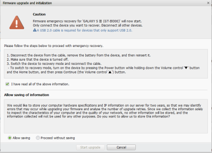

Thank you for your awesome tutorial. I have successfully completed up to item 11. However at the firmware installation page when I tick the box that I understand or agree, the 'start upgrade' button is still greyed out. This is regardless of whether I allow to save or click 'proceed without saving' or sending info to samsung or whatever t wanted me to do.
I have a Samsung Galaxy S3 which has crashed after downloading the latest software update.
Also, after I put the phone in Odin mode and it was connected to the pc via a usb, it said 'Downloading... Do not turn off target!!!' for 5 hours without proceeding further. I thought if the firmware installation 'start upgrade' button was accessible, something might start happening?
If you're able to offer any insight or assistance I'd be most grateful!

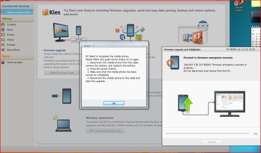

Hi I've tried the above method and get to step 11 and it stops working after the firmware has fully downloaded. It tried to upload on to phone but this is what happens: Capture.JPG
Please any help would be appreciated.
Thanks in advance

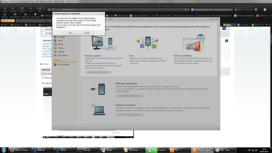

Hi I get past step 10 then this pops up
Is it safe to say yes and proceed or is this not part of the guide??

HI EVERYONE. Can somebody help me. I have done all the steps and now im stuck with this. I cannot click 'start upgrade' what should I do? :( Please help me.HUHUWHATTODO.png
Re: S3 Frozen on Samsung Start Screen after Software Update
Hi, I am now currently stuck on the firmware initialization. I have done everything that you have told me but it wont start upgrading

Hi
I had the same problem with the "start upgrade" button not active. However I left it running for a couple of hours and it then recognized the device and the button was not greyed out anymore. So you just need to give the machine some time to recognize the device and the button becomes active. Everything else worked fine and I did not lose any of my data.
