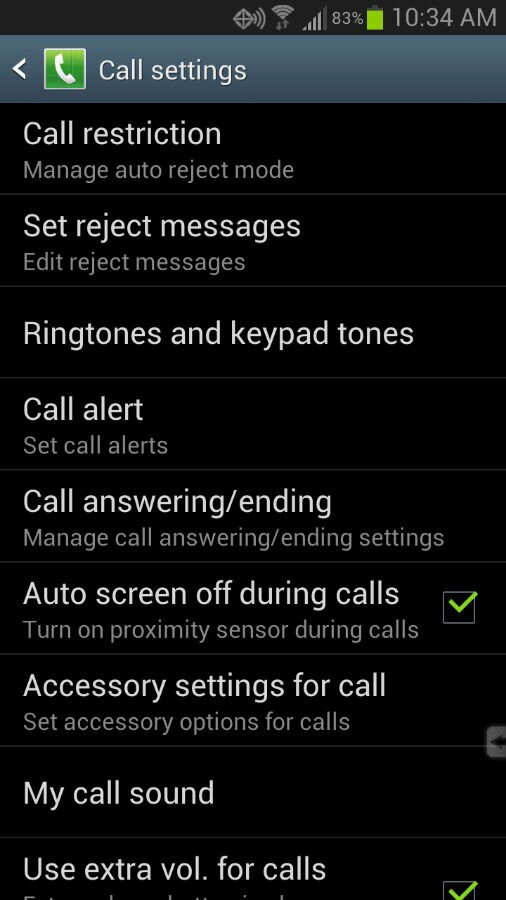

Hi. I dropped my phone and have a cracked screen. I've had no problems with emails, apps, pictures, text messages. The only problem I have is using the phone for actual phone calls. My phone rings and I answer it, as soon as I answer it, the screen goes black and I'm unable to do anything after that. I can't switch over to another call for call waiting. I cannot end a call. I have to wait for the other person to disconnect on their end. I can call in to check voicemaill but then the screen goes black and I can't get the keyboard to appear to do anything with my messages from there. I can place a call out but as soon as I hit send the screen goes black and I'm unable to do anything from there. If I don't reach someone, I get voicemail, I can't do anything or disconnect until it disconnects from that end. Which as you can imagine is using up my minutes. Also, if I have to call an automated number and make selections through the automated system via the keyboard I cannot make those calls. My question is how is this possible that everything else works via touch but somehow the phone function isn't working at all since dropping the phone. I have done the battery pull and that did not correct any issues. I'm hoping I don't have to spend $300 to get the new screen/digitizer replaced??:'(
It sounds like something has happened to the proximity sensor.
As a workaround you can try this - start the Phone app, press the Menu button, select Call settings, then uncheck "Auto screen off during calls"
Edit: In that same menu you can also select 'Call answering/ending', then in the next screen enable 'The power key ends calls'.
