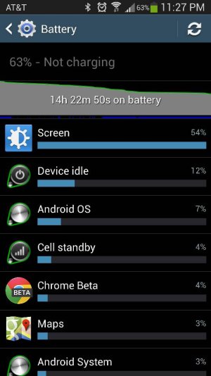

This is on moderate usage with most motion features turned off. I just don't have a need for them.
Sent from my SAMSUNG-SGH-I337

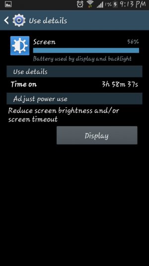

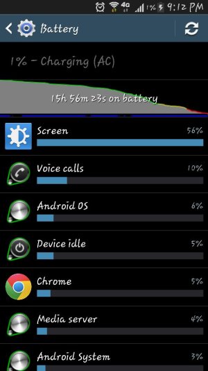

Here's my battery uses with all the air features off and moderate to heavy use. I think I'm doing well. Took it off the charger at 5:30am and about 9:00pm is when I had to charge.
Sent from my SGH-M919 using Android Central Forums
