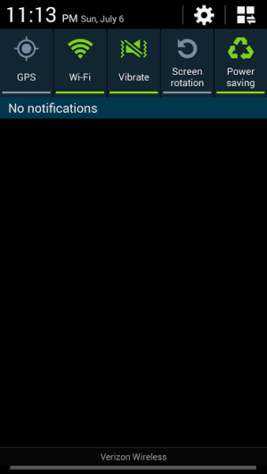

Yesterday the brightness slider randomly disappeared from the notification bar while the device was at about a 90% charge, with power saving mode off.
I have done all of the following multiple times, to no avail:
-Toggled the checkbox in Settings.
-Restarted the device.
-Removed the battery for extended periods.
I am guessing that one solution would be to hard reboot the device, but I am hoping to find a solution for this issue without having to do so.
The notification bar looks like this:
Any help is greatly appreciated!

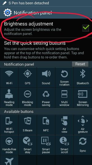

Do you have this ticked?
Posted via Android Central App on my Note 3

I don't have any "night mode" app, but I just lost the brightness slider, too. I tried the same things. It's currently marked to show and it looks like your picture above.
I don't know what to do :-/
