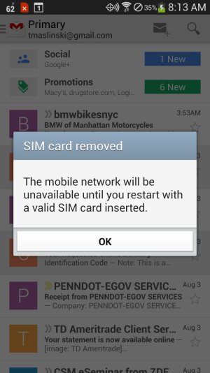

I have been experiencing the same problem on brand new Galaxy S4 from Verizon. At first it happened 3 weeks after initial activation. I was able to get it back by removing battery. It worked fine for few days, but than it happened again. This time I wasn't aable get the sim card to show up. After calling Verizon tech support I was advised to try booting in the safe mode. this works fine and the sim card registered.I was told most likely one of the applications that was installed by me is causing this problem. unfortunately even in the safe mode the same issue with SIM card came back after few days. After playing around re booting into Safe Mode I'm back into a normal mode I was able to get the sim card to register again. Unfortunately this problem is now happening almost every hour and I have to keeps on rebooting my phone each time Verizon is suggesting to insert a new SIM card, but from the previous posts: I see this was not resolve my sim card problem.

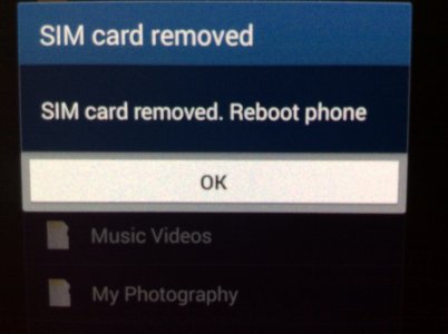

The exact same this is happening. I've had my phone since June 2013 so less than a year and my phone tells me no SIM card when I actually have a SIM card in it. It's really annoy because it's happened in the past but it worked after a few restarts. However it's come back again and now it won't go away, I've tried restarting if a few times, I've turned it off and on, I've even ejected the SIM card and pulled it our and out it in a few times and it works but then it comes back randomly later. This kept happening yesterday and then once I got it to stop, I came back this afternoon and I'm furious because it's annoying and what if I need to call someone and it won't let me do that.
