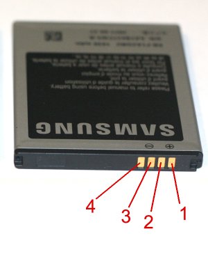

HEy there TIP form me,
as i searched a solution and test much of things i would to say this...
The problem is cause of the NFC chip on top of the motherboard of the S4. to fully solve this problem u need to change it and its expansive.
an other way is (i test it today dont know solve it fully but seems like that) is to close the NFC Connector on the battery with an tape. So if the NFC chip does not become power means no NFC is activated on the motherboard. So it should be not issue anyway again. So its the last Pin Nr. 4 (under the " - " symbol. Only close it with a tape and replace your battery agian to phone and restart.
In my Phone its work :-)
look the picture close the Nr. 4 pin

Thanks, this worked for me! Lately I've got this message several times a day. None of the other fixes worked, so I tried this. After 10 days with tape on the battery, no message on my phone.
Thanks again!
