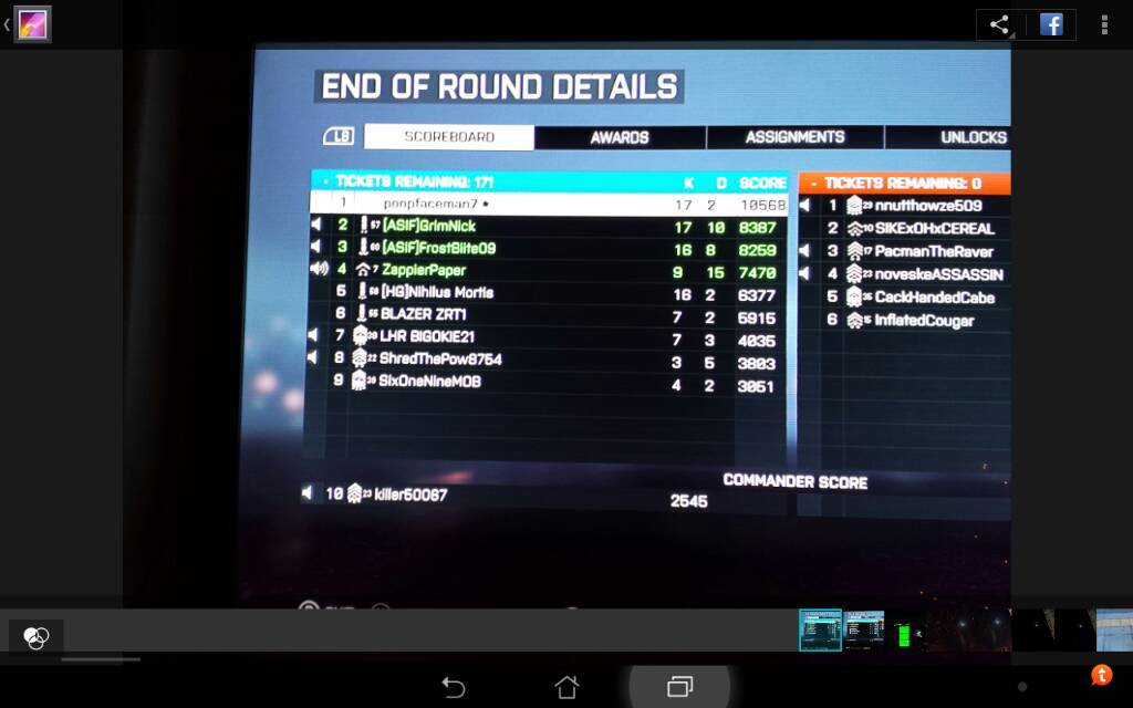

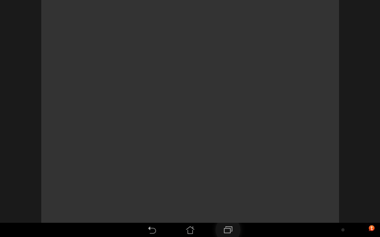

So I'm on my tablet right now and tried viewing the files on my SD card. I see that the files that were corrupt on my phone are also corrupt on the tablet. The files that are fine are also fine on the tablet. Here is what I can see:
The first photo is a screenshot of one of the latest functional shots I took with my phone before the corruption started once again. The second is what I see when I try to view a corrupt photo with this tablet. The last is showing the cut-off of when the photos became corrupt. I didn't use the card for quite awhile, which would explain the difference in time when the photos went bad.
I now want to try to use my tablet and load this card with photos to see if the corruption has anything to do with the card. I'll first keep the card as is and see if the corruption "spreads" to other files. Then I'll reformat it through this device and try again to see if things work fine. If so, then the card would not be at fault with the corruption.
Sent from my ASUS Transformer Pad TF300T using Tapatalk
