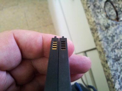

I had the same problem. I received a replacement battery. it did not happen with the new battery. since both batteries were Samsung original I did examine if there is any difference. to my surprise I did find that there are differences. The first battery that would die on me have the electrical contacts indented (more inside the plastic). See pictures. My suspicion is that the first battery looses contact (from the mating pins) and then the phone turns off.

Clean the connectors on the battery.That should do the trick.Seems there comes a film layer on it in time
