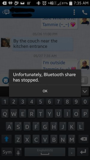

This is what appears on my phone whenever the Bluetooth drops:

I had the same issue. I fixed it by disabling "Automatic Message Transfer"
Everything else works without any issues now.
