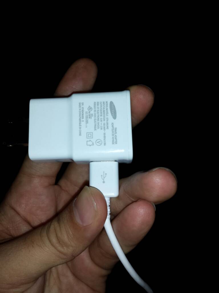

One thing I've noticed is that with the Samsung 2 amp chargers is that the usb plug that goes into the wall adapter sometimes it doesn't go in all the way and it affects device charging. It happened with the charger that came with your phone and then another Samsung charger I bought.
Just as a precaution I guess just make sure that the usb is fully seated in your wall adapter.

Ha anyone noticed their usb cables not plugged in all the way into the wall adapters? This happened with two AC adapters for me. One that came with the phone and one genuine Samsung one I got to use at work. In both cases the phone would show charging but wouldn't charge.
It felt like it was plugged in all the way when I first plugged it up out of the box. But obviously not.
Then I reseated the cable and it went in all the way. And then the phone charged properly.
I only mention this cause it happened to me twice with two different cables. When they are brand new they are tight and felt like it was fully seated when it wasn't. Once you pull the usb cable out and reinsert it goes in all the way and from there on its fine.
Worth a look.
