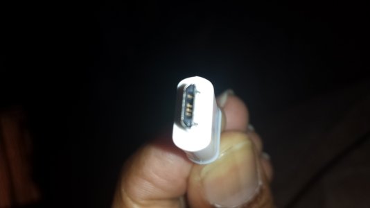

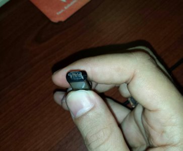

I think I found my problem thanks to a post about the USB cord being different from others. I proceeded to inspect mine and realized a pin is missing from the end that plugs into the phone. It appears the stock Samsung cord is inferior. I replaced it with one I had from a previous device plugged into the charger that came with the phone and it is working just fine.
My cord looks the same and charges just fine.

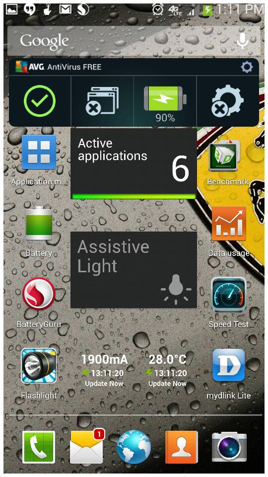

One recommendation I have is this widget called Current Widget that monitors charging current. Extremely useful especially for those having charging issues.
https://forums.androidcentral.com/e...ils?id=com.manor.currentwidget&token=sw8z9qdu

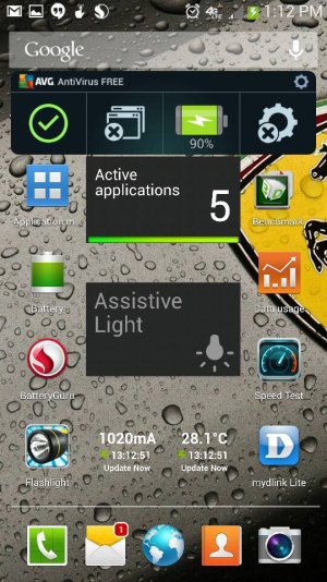

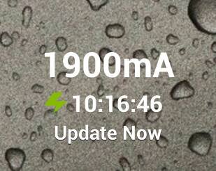

Using the white 2amp Samsung charger and cable that came with the phone and also the black spare one I bought to use at work it shows 1900mA when charging.
Using the same cable on a generic brand 1amp charger I get 1020mA

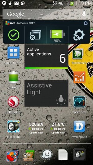

Using a cheap 500mA charger it shows 520mA

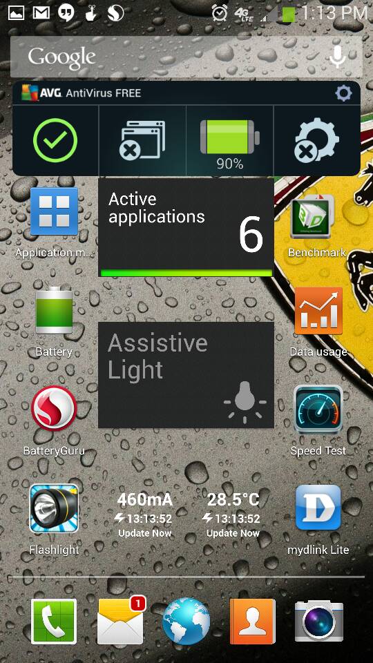

Discharging it shows 460mA which I assume is the draw on the battery. Interestingly enough with this widget it doesn't fluctuate. And charging over USB it shows charging and 460mA also. Which I guess means that over usb to computer the device just holds the charge.

I know my comment gets buried and I keep saying it over and over and over again. But use this widget and you can see what your rate of charge is. You don't have to wait to see if your phone is getting a charge. A 2amp charger will show in this widget that it is drawing 1900mA.
Use it use it use it especially if you've had charging issues..
