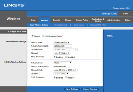

I agree with the other two post. I also have and Galaxy S6 and had a similar issue, in my case the phone won't even see the 5 Ghz network at the beginning of my troubleshooting.
After some forum reading, troubleshooting by trial and error I have manage to have a 5 Ghz stable connection to my phone. apparently Samsung phones can see certain 5Ghz channels depending on the region where your phone is for. For example US phones will work on channel 36, probably 38 & 30, but for other regions Europe, Japan and in my case Latin-america other channels apply.
My recomendation is:
  1. Have separate SSID for 2.4 and 5 Ghz
  2. Leave Wireless A on the 5Ghz band and have Mixed B/G and N on the 2.4 GHz (that way you leave a fast writeless connection to cover more areas of the house.
  3. Change the channel settings to a fixed one; for 2.4 Ghz use the less crowed channel (You can use WiFi Analyzer app for this) and for 5 Ghz use the Channel that your phone* can see. This will be trial and error until you find a channel that your phone is set up.
See setting for my Lynksys Router.

Have a good day
Erasmo
