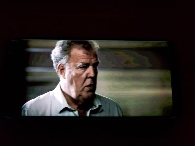

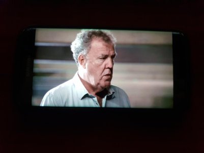

This is the issue on my S9+ compared to my old S7 edge, and I must say it looks pretty pretty pretty bad:
Galaxy S7 edge
Galaxy S9+
Galaxy S7 edge
Galaxy S9+
Wow, that looks just like the Pixel 2 (non-XL) phones I tried and returned that had horrible black crush resulting in blotches and blockiness. Yuck. Google still hasn't fixed the Pixel 2, hopefully Samsung will fix the S9+.
