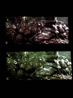

On mine the eggs issue is visible in all brightness levels. It does get progressively worse though as I go lower but still can't match the S8 picture even at maximum level. Leave your screen on Auto brightness in a dark room if you're unsure. If there is an issue, it should be clearly visible there.
You did a screenshot from your phone for the eggs test but that doesn't help us see if you have the problem. Only a photo of your phone would show it to us.
But you should be the ultimate judge of whether your display has the issue. Does your screen look more like the S9+ photo I uploaded in the previous post or more like the S8?
Im in a dark room with absolutely no windows or outdoor lighting at all. I re-set the screen to auto and the brightness is just below the second button, which in my case, its bluetooth. Again I put it to comparison with my Note 8, on top, and s9+ bottom. received_10215618196477397.jpeg

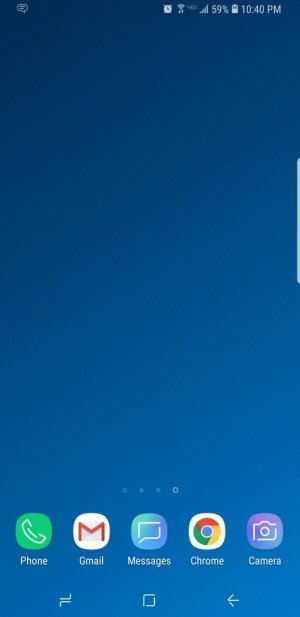

That is not the intended gradient. This the solid blue background. I didn't notice it until I was in a low light setting.
To reiterate, if you are trying to show the problem, you have to photograph your phone. A screenshot will not show the problem.
