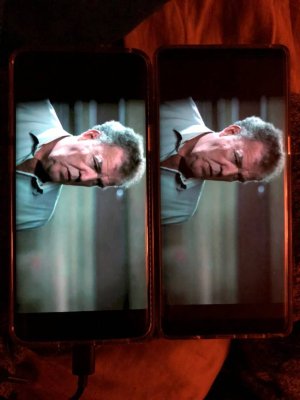

The photos were taken from The Grand Tour (Season 1, Episode 1). I was streaming from the Amazon Prime Video app. You can check it out at about 01:15 min:sec.
Since this is affecting only S9+ so far, it looks more likely to be a hardware fault. Video codecs and resolution has nothing to do with it since the problem can be reproduced using simple screenshots that appear normal in other devices.

Can you tell me if my phone has that issue? Top is my Note 8 and bottom s9+.

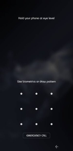

This is what I find on my infinity wallpapers but only the gray one. Right, middle side has a dark spot and top left corner too... Idk if that's part of the problem or just the design on the wallpaper Screenshot_20180322-203126_Samsung%20Experience%20Home.jpg

From the photo of Jeremy you provided, no, I can't see the issue.
As for the wallpapers, mine displays significant colour banding in low light. It is more apparent with blue and purple wallpapers. The dark parts of the wallpapers appear grainy and the colours don't smooth evenly. There is also a greenish tint in the dark areas.

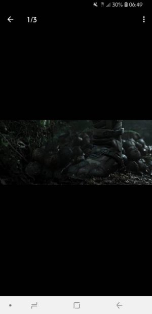

If you want to try out another experiment, go in a dark room and try the following screenshot:
Pay attention to the eggs in the left of the scene.

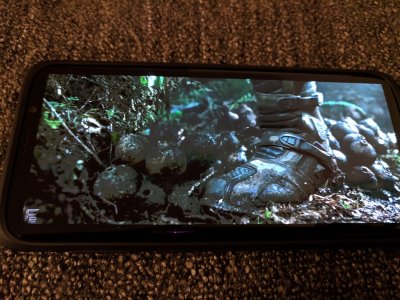

If your screen looks like the photo below, then you have the problem:

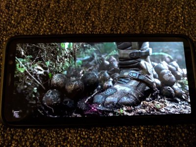

If it looks more like this then it's probably fine:

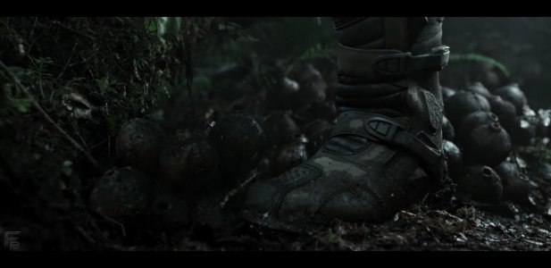

Hi all! I created an account here just to bring you the reference image (1080p) based on Kristians photos :-) I liked this one as it clearly depicts the difference and you can spot it easily. My S9+ is arriving next week and I'm curious whether it's affected. Thank you for all the useful info in this topic.

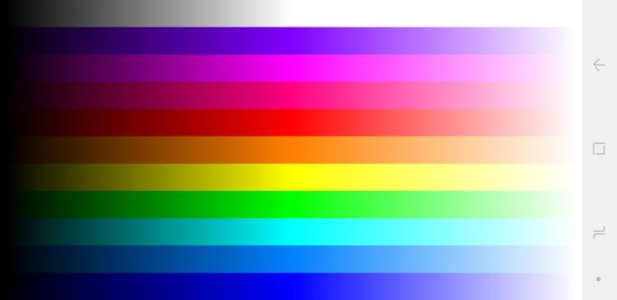

This is how mine looks, and I also attached the banding Screenshot_20180323-064910.jpgScreenshot_20180323-063509_Display%20Tester.jpg

On mine the eggs issue is visible in all brightness levels. It does get progressively worse though as I go lower but still can't match the S8 picture even at maximum level. Leave your screen on Auto brightness in a dark room if you're unsure. If there is an issue, it should be clearly visible there.
You did a screenshot from your phone for the eggs test but that doesn't help us see if you have the problem. Only a photo of your phone would show it to us.
But you should be the ultimate judge of whether your display has the issue. Does your screen look more like the S9+ photo I uploaded in the previous post or more like the S8?
